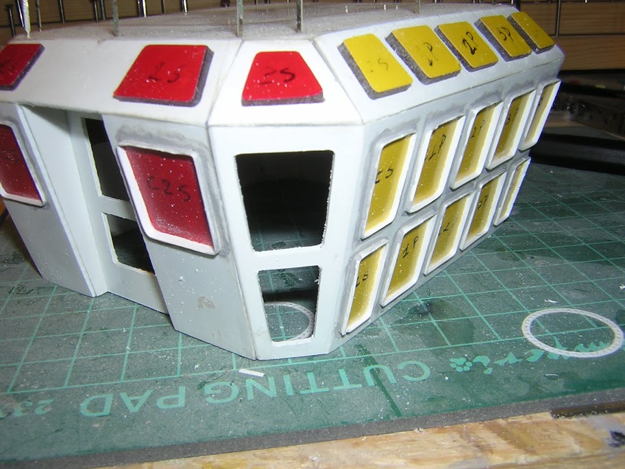

Hello all, to change a little bit the "usual gruel" of the accessories, I continued in the construction of the wheelhouse windows
To achieve proceed as explained in the construction diary of my smit nederland. In practice I have realized the jigs vinyl adhesive that I applied to a Plexiglas sheet 2 mm thick. With tunnel and bench grinder I finished the edges of the windows following the profile of the templates.
Not to confuse with the various windows, I used vinyl in various colors.
The vinyl I will remove it only after having painted the wheelhouse.
When I've finished editing all the windows, the steering will appear as the Rubik's cube.
Hello, I step a few photos of the wheelhouse windows. In practice I have almost finished the 47 windows. As mentioned in previous messages, I applied a syringe needle to the spout of the tube of glue to have a microdosing and prevent sagging
Ciao Ciao
« Last Edit: February 24, 2017, 01:39:59 by ALIMURIMETA »
