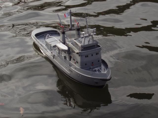

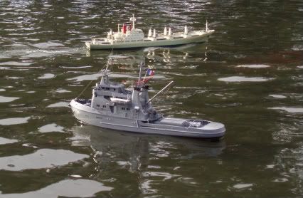

Hi guys, new here. "Toot" don't be put off by what falls off, when I got my "Amsterdam" it had the same problem "dropsie", seemed like every time I looked at it any thing made of white metal would fall off.
 I decided to repaint it and rename it to the "Tenace" a French Navy tug.
It is a work in progress, with still a bit to do on the old girl.
I found that if a fitting falls off that I want to keep, I drill a 1mm hole in its base and fix a piece of wire in the hole, then drill a hole where I want it to go and secure it with with glue, so far so good. Works for me.

Hey!  That looks nice.  You give me hope that life might return after all to the old girl! :-[

Oztruck's French navy is a good alternative colour scheme. The Malabar was previously stationed at Muroa Atoll.
